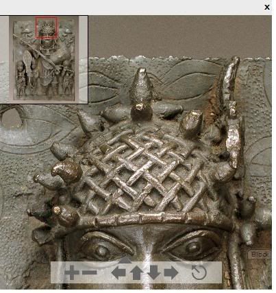

I understand that other metals besides steel can be used in the construction of helms. Is there anyone out there making faceplates in brass, copper or bronze?

No. I want to look just like these guys with the croc tops and full face plate. But i want it in bronze, just like the plaque, so it matches my skin tone. Maybe I'm asking too much and should just get it done in steel and have it treated to look like bronze.

nkante wrote:No. I want to look just like these guys with the croc tops and full face plate. But i want it in bronze, just like the plaque, so it matches my skin tone. Maybe I'm asking too much and should just get it done in steel and have it treated to look like bronze.
I'm not familiar with the original armour depicted in the plaque. Are you sure those are metal and not crocodile hide & natural materials?
If the later, you could have a metal helm made, with the face constructed similar to the faceplate/mempo of a Samurai's helm (Photo's of Nissan Maximus' and others are on this archve) and simply use real croc or alligator hide on top of a steel helm for a realistic look and construction, with SCA levels of protection.
I don't know how well the alligator or croc would hold up, but it would be unique and badass.

Historically it was croc hide over twisted fiber. I'll do anything to piss off PETA. But I want to use metal simulating croc skin with a nice bump pattern. I used faux gator over my current helm but it doesnt have the impact I want it to. Plus it gets messed up alot. I want to look like i stepped of the plaque. I was contemplating the mempo idea. Brazing, is that heating the steel until it turns color?
