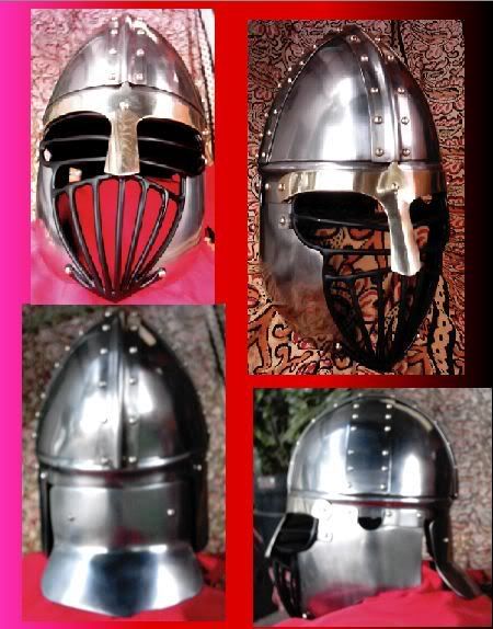

That is looking really good. I'd like to make a suggestion on the bar grill. Instead of doing horizontal bars, (like you did on the roman cav helm), do something similar to what Windrose and WMA do. This avoids the football helmet look. Also, paint the grill flat black, and it will not detract from the look of the helm nearly as much.
Something like my helm.

That's not a bad looking bargrill Garreth, it gives me ideas, thanks.
