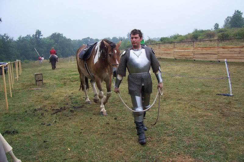

Here's a pic for better reference. I wasn't wearing my schynbalds, right demi-gaunt, hose, lowboots, or my nicer belt. My spaulders are also tied directly to the gambeson now. At least you get the idea how high up it needs to go to provide good cover.
Once I get the skirt done, I'll add voiders, then leg wraps.

chef beat me to it. you really can't wear just a maille skirt with just a single breastplate. if you had some lames off the bottom that would be one thing, but if I were you I would get a full shirt. Here's my (partial but relevant to the discussion) rig:
Hope that helps!

Cool beans - nothing looks more 14th century, than a haubergeon with plate armour over it and around it, augmenting it.
In my eyes, one of the biggest visual gaps in some 14th century kits is wearing such things over gambesons, with no mail in sight other than an aventail.
