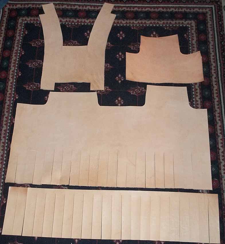

so in with this conversation does anyone have a vid or simple and easy to understand pattern and instructions for making pteruges if I am able to set aside funds I will be getting a roll of leather from the leather guy some time this month, I will be trying to get 8-9 oz black or burgundy (if i can find some)
I made some for my first kit but got 14 oz and yeh well that did not work out. also the way I did it was cut out long and short individually and then rivot them overlapping it was a pain in the neck any pointers?

Eek, yeah, don't do them individually! Maybe my Greek leather armor will help?Kain556 wrote:so in with this conversation does anyone have a vid or simple and easy to understand pattern and instructions for making pteruges if I am able to set aside funds I will be getting a roll of leather from the leather guy some time this month, I will be trying to get 8-9 oz black or burgundy (if i can find some)
Just ignore the top half of the photo, since it's not really relevant to this. Basically just cut 2 rectangles, the inner one an inch taller than the outer one. Cut the slits about 2 inches apart, almost to the top edge, making a big fringe. Then just put them together with the slits staggered. That means the inner row will stick out beyond the outer row at one side, making a neat overlap where your opening will be.
If your leather isn't large enough to cut both rectangles in a complete piece each, you can easily cut two or more pieces as needed. My inner row of flaps actually needed a 2-flap piece tacked on the end--you can see it at the left end, but once the thing is assembled the joints are invisible, of course. (That's assuming the top of your pteruges will be covered by your armor!)
One important point is to try to match your circumference. You don't want a gap, but you also don't want excess length that will end up being overlapped or bunched (since heavy leather doesn't really "bunch" very well!). If you expect to expand over time, it's not impossible to add flaps--might be handy to make a few spares right now!
Good luck!
Matthew
Re: Roman Officer, 1st C AD
Achilles of Sparta is the one who gave me pointers on my first set his are kinda awesome this pic does not do it justice at all
I think the mentality is that if they rip off it would not be hard to pull a few rivots and replace a section and that the way they lay ontop of one another there should be no massive gaps in coverage, for him he uses zoombang and this as his only thigh coverage.

Above is how I did mine for my roman kit, though mine are knee length.
