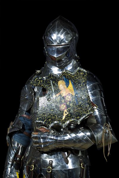

I am quite liking mine at the moment ;)

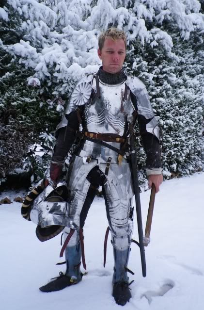

by Kaos
Your harness sucks Ben. It so fully lame. I am giggling as I write this. Yours stinks fella!!! Haha. Look at Ben's pics and cry people.
:lol:
I agree it stinks! That arming doublet really needs to be washed!
The fun thing is, Andrew's and mine are very similar, but both have distinct personal adjustments.
I like my armour to be light on the arms and legs and heavy on the crucial areas.
Regardless of it being hardened and tempered spring steel (in my opinion a must for jousting) my pauldrons are 2mm with a gardbrace of 2mm. Sallet is raised from 3mm with a visor of 2mm. Grand bascinet 2 mm, but jousting visor is 3 mm on the lower lip. Arms 0,5/0,6 mm.
Other people prefer to use the extra strength of spring steel to go lighter, but sheer mass provides a lot of protection.
It's a very personal choice and the only way to figure out what you like is to look around and see what others use and ask for their experiences. Also ask if you can look at and feel their individual pieces, it will help you figure out what you need.

Andrew McKinnon wrote:I am quite liking mine at the moment ;)
Andrew what kind of helm do you use for ground events?
Re: Jousting Harness
Posted: Sat Apr 07, 2012 1:16 am
by Andrew McKinnon
This armet for ground combat and balsa jousting.
These spaulders as exchange pieces for foot combat too.

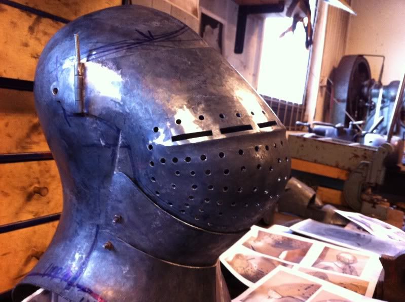

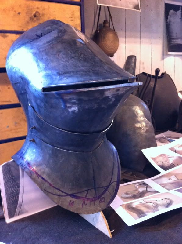

Kaos wrote: Grand bascinet 2 mm, but jousting visor is 3 mm on the lower lip.
Have you posted pics of this yet?
If so I must have missed it.
Your dawn photo shoot looks great!
Are those the same legs you got from Stanislav a few years ago?
Did you ever get the sabatons to work out?
Tom
Posted: Sat Apr 07, 2012 12:52 pm
by Kaos
Tom
Hi Tom,
Thanks! These are indeed the legs Stanislav made me, still happy with them and they serve me well. In the grand plan of things I might need to replace them in two years, as they aren't perfect for the image I have in mind. Not entirely happy with the shape of the knees for example, but they function fine.
The sabatons never worked out to be useable, so I gave up on those. Hopefully next time I'll have more luck. :)
The grand bascinet is a work in progress at the moment. In fact it went to the hardening workshop this week. I went for a fitting in Sweden two weeks ago and am very happy with the shape. It's a replica of the Frederic the Victorious grand bascinet, with extra joust visor. I have a melee visor planned for it next year.
Here are some sneak peeks:
Andrew.. Please stop posting pictures of that armet. It hurts me.. :P

by Tom B.
Kaos wrote:
I like my armour to be light on the arms and legs and heavy on the crucial areas...
Arms 0,5/0,6 mm
Wow! That is very thin. Something like 24 to 26 gauge.
Is this the final thickness after grind and polish or the initial sheet thickness?
How thick are your gauntlets?
Tom
Posted: Sun Apr 08, 2012 2:01 pm
by Kaos
This is the thickness after grinding, I checked again and it leans more to the 0.7, but still very thin.
This is for the vambrace and rerebrace only, the couters are ca 1.3 mm. They hold up very well, the temper is awesome.
My gauntlets are 1.6 mm mild steel, all three pairs. I recently bought a new pair on the Archive from Volodymyr Lunov, which will hopefully provide better lance control than my current favorite pair. They are more fitting for the style of my harness as well.
I hope to have funds for a spring steel pair in a few years time.. These are the only parts of my armour that's still mild. I have been planning this project since 2007. Hopefully it will be complete next year. It has taken a lot of patience, although I did take some detours by buying the current arms and some other pieces in between.
This is the brass of Richard Quatremayne on which it is based:
I think it's very interesting how this stained glass depiction of Richard Quatremayne also shows the same legs:
Tom
Hi Tom,
Wow that looks great!
I bet you can't wait to put it to use.
