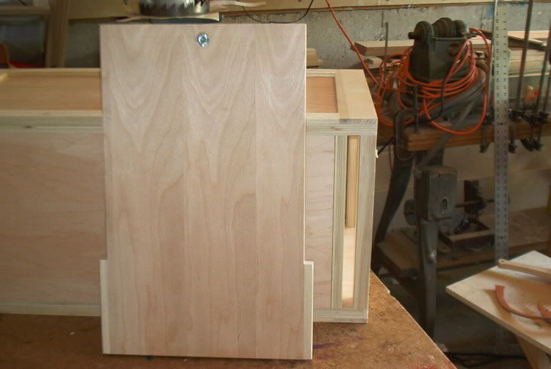

by Maeryk
So my wife said she was "Tired of living out of totes" while eventing.
I volunteered to make "a box".
I settled on a clampfront, modeled vaguely on the Canfield Coffer, and found some plans online to work from.
It's a bit bigger than I envisioned:
[img]http://i11.photobucket.com/albums/a181/maeryk/mebox2.jpg[/img]
Solid poplar, the sides are actually pegged and glued into the ends, and the bottom is glued and screwed into glue blocks glued along the sides. Lid is also poplar, and will be hinged, and currently, the whole damn thing is bright pink, cause that's the color primer we had left over from painting our room burgundy, and it gives the best "shine through" to the maroon and beige paint that will be the final design on the box. :)

by Donal Mac Ruiseart
First thing I thought when I saw the pic with you sitting in it was "Coffer or coffin?" :)
What are those little compartments at the ends?
And where do you get such wide slabs of poplar?

by Maeryk
They aren't compartments, they are the handles for the chest. I put one about the level of the bottom of the "box" part as well, to make it easier to lift higher.
(The original had the same type handles. Canfield Coffer).
Not wide slabs.. well.. the uprights are one piece, but the rest of it is glue-ups.
Posted: Sun Jul 20, 2008 9:52 pm
Ah, I think I get it . .. the slabs at the ends are only a few inches wide, supported by the extended planks at the corners.
I like that, the problem of handles has always perplexed me
And the floor is sturdy enough to take your weight . . .
Posted: Sun Jul 20, 2008 10:06 pm
by Maeryk
The "wings" from the vertical legs (the front and back of the chest) extend past the "end" of the compartment a good 2.5 inches. There's a milled piece of 3/4 x 2" wood flush with the outside of that. Lid battens can fit nicely in the "gap" (or not, I've done it both ways).
I put two handles on each end.. one level with the top, and one level with the bottom of the compartment. (Much easier to lift into the car with the lower handles).
And yeah.. I stood on one foot and bounced a bit in the dead center of the floor. It's milled 3/4 (ish.. probably over a bit.. I just got to "all boards smooth and same thickness) poplar edge glued and biscuited, and then glued and screwed around the edges to 3/4x3/4 glue block strips that run the perimeter of the base. They are in turn glued and screwed to the carcass.
The lid I thinned down to closer to 1/2 when I planed it, cause.. just.. yeah. That's a big, heavy assed piece of wood, and it really doesn't need to support cars or anything.
Bear in mind.. the Canfield Coffer, (and, in fact, many of the REALLY DAMNED BIG surviving boxes, like the Voxthorp) were built to have the valuable church items locked in em. Too big to move, to solid to break into.

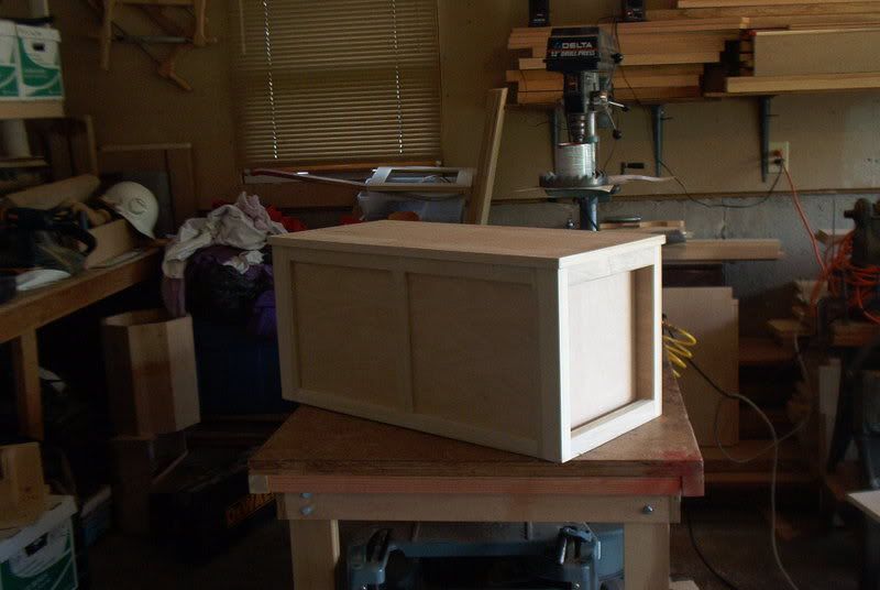

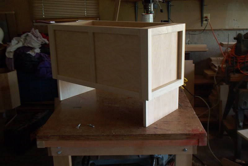

by Baron Conal
I found the pictures of the prototype with removable legs....
this was the idea testing prototype, a little rough around the edges.
Posted: Thu Jul 24, 2008 5:57 pm
by Maeryk
Neat! I really like that!
