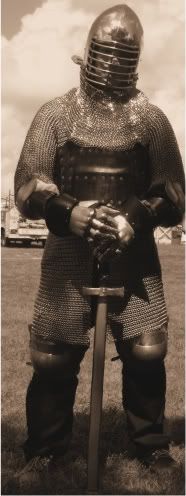

Posted: Sun Sep 20, 2009 4:14 pm
by Pietro di Trento
Just a quick update, I wouuld appreciate anymore advice I wanted to go earlier 14th c. but seems I am more mid now.
Posted: Sun Sep 20, 2009 4:28 pm
by audax
Greaves or shynbalds. A surcote. Simple soupcan type knees. Proper shoes or cover the mundanity. Blacken the bargrill.

How can I blacken the bar grill without painting it?
Posted: Sun Sep 20, 2009 4:52 pm
by Cian of Storvik
Warm it up with a hand held map gas torch. Spritz with WD-40 and then hit it with a torch again.

jmperez wrote:How can I blacken the bar grill without painting it?
What's wrong with painting it? That's how I blacken mine.
I suppose you could use cold gunblue.
Posted: Sun Sep 20, 2009 5:32 pm
by Ernst
jmperez wrote:Just a quick update, I wouuld appreciate anymore advice I wanted to go earlier 14th c. but seems I am more mid now.
If you really want to go earlier, you can. First, a long surcoat will go a long way. Next, you need to get long sleeves on that hauberk. I would also fill the "riding split" with expansion rings to allow the mail to flair instead of gap. Audax is correct on the legs--greaves or schynbalds beneath "soup can" poleyns. Gamboised cuisses are good. I would prefer a more centrally-pointed bascinet as well, but the money's been spent.

Posted: Sun Sep 20, 2009 7:55 pm
What Ernst means with the slits is to add right triangles of plain-weave mail, or expansion triangles, to either edge of the slit. Height of triangle zipped onto the edges, hypotenuses to the centerline. Though I am not quite sure I'm seeing an inverted-V gapping here.
Your kit is definitely looking more united in time. A lot of what else you might do would be on the level of accessorizing in c. 1350s style, trying for whatever telling little details you may, that bellow mid-fourteenth as opposed to late or very early.

Posted: Mon Sep 21, 2009 9:01 am
by Tailoress
OMG, what an improvement. Awesome to see! I think you need to concentrate on your legs -- start wearing braies and hosen, not pants. Also, get real turnshoe boots to fight in (put orthotics in them to help with all the weight on you). That will help bring it all together in a very real way.
Posted: Mon Sep 21, 2009 11:03 am
by Tomburr
Yeah, go with hosen and turn shoes. It'll make a huge difference, and really take your kit up a notch in historical accuracy and appearance.
The bascinet was a great improvement. I think its really awesome that you're taking the advice of the old hands around here and showing your progress. At this rate, you'll have a very respectable kit in no time.
Keep us updated!

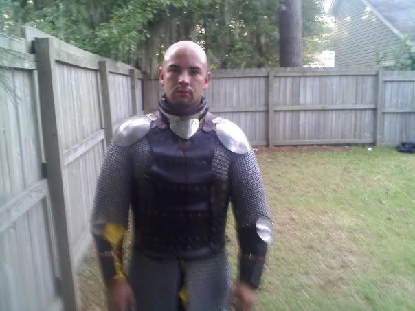

Posted: Wed Oct 07, 2009 10:53 am
by Pietro di Trento
Just an update finally attached the spaulders
Posted: Sat Feb 27, 2010 10:51 pm
by Pietro di Trento
I made some changes to my kit I change my Elbow and knees from articulated to single cops added splinted greaves. I would like to thank Josh W for his help. I need to get rid of the modern boots and still need an arming coat but I am finally satisfied. I also made a plaque belt
Posted: Sat Feb 27, 2010 11:25 pm
by Qwertypolk
A HUGE improvement! Well done!
Posted: Sun Feb 28, 2010 7:34 am
by Angusm0628
Looking Good..... light years ahead of your appearance from the opening pic you posted....
Posted: Sun Feb 28, 2010 8:12 am
by Jestyr
Very nice job. As a previous poster mentioned, you are now light years ahead of where you were.
