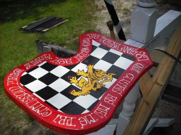

For those looking to move up to balsa jousting and plan on using a shield rather than a grande gard, Vitus makes a virtually indestructable shield and Sir Angus (Jeremy O'Neil) does as well. You won't go wrong buying a shield from either of these two worthies

Lloyd - FYI: that first pic above is of Michelle Walker.
I know this because I have that armour sitting in my dining room.
Unless Rod wears his wife's armour...
