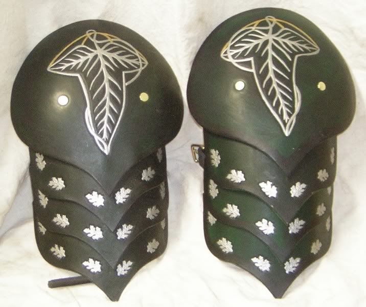

Here is a custom tooled set of bazubands and pauldrons I just finished.

by Thjoren Grimwulfe
The leaf on the shoulders is that the lothlorien leaf from LOTR? Nicely done. What are you using to finish them and keep them hard? Also did you use just an acrylic silver paint or is it leather paint?
Did you dish the elbow or is it natural from the sewing together?
Thanks
Thjoren

Thjoren Grimwulfe wrote:The leaf on the shoulders is that the lothlorien leaf from LOTR? Nicely done. What are you using to finish them and keep them hard? Also did you use just an acrylic silver paint or is it leather paint?
Thanks
Thjoren
Torvaldr water hardens, then impregenates the leather with a beeswax/carnauba wax blend. I have a pair of his gaunts and they are excellent.

I do not want to discourage folks from ordering tooled stuff, but tooling can add considerable time to any order. Up to double the normal construction time. I have psoriatic arthritis so my time to tool is limited to good days for my hands. I try to be upfront about that before I take a tooling order.
On my process. I use water shaping to mold and dish the leather. Oven bake it and them run it through my wax mix, then another oven bake.
For the paint I use either medium viscosity acrylic paints. Or acrylic miniature paints. Especially the metalics.
I currently am a little behind due to the medical procedure I went through last week, but I have just completed 3 orders and have 3 more due out in the next 2 days.
