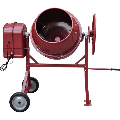

One of the items I acquired from the the estate of the Late Will McLean is a small cement mixer full of bran that he used to use to keep his mail clean. While this does not really tell us much about medieval practice, it does offer a modern way to uses a traditional medium. The mixer is one of these guys from Horrible Freight.....
...and the bran came from a local feed store. All in all, it represents less than $175 for the whole cleaning system. I would bet that you could score a used mixer on Craig's list that would drive the investment cost down below $100.

Results, from not being able to see any details at all, now you can see alternating rows of riveted and solid links. I used a computer power supply, wire, scrap metal for electrode, 5 gal plastic bucket, electrolyte.worldantiques wrote:Here is a perfect example, this is a very old and very rusty 20+ lb hauberk in a 12''x12''x5.5'' box, it has been sitting in someones house for several decades, somehow I need to remove the rust in order to photograph and identify it. I am not looking forward to rolling it around in a barrel, I have been contemplating trying the electro rust removal method which I have heard was used sucessfully on a large number of very rusty Indian armors from the Bikaner Armory that were sold in the 70s. Does anyone have any alternate modern non-destructive rust removal methods?Ernst wrote: A 20-35 pound hauberk doesn't take up a lot of space: Think shoebox size.

Doing a “compare and contrast” would be even better, but just trying and writing down how this compares to other polishing methods would be interesting! Because I travel so much and spend so much time buried in books, I am better at finding different ideas than trying them out.
