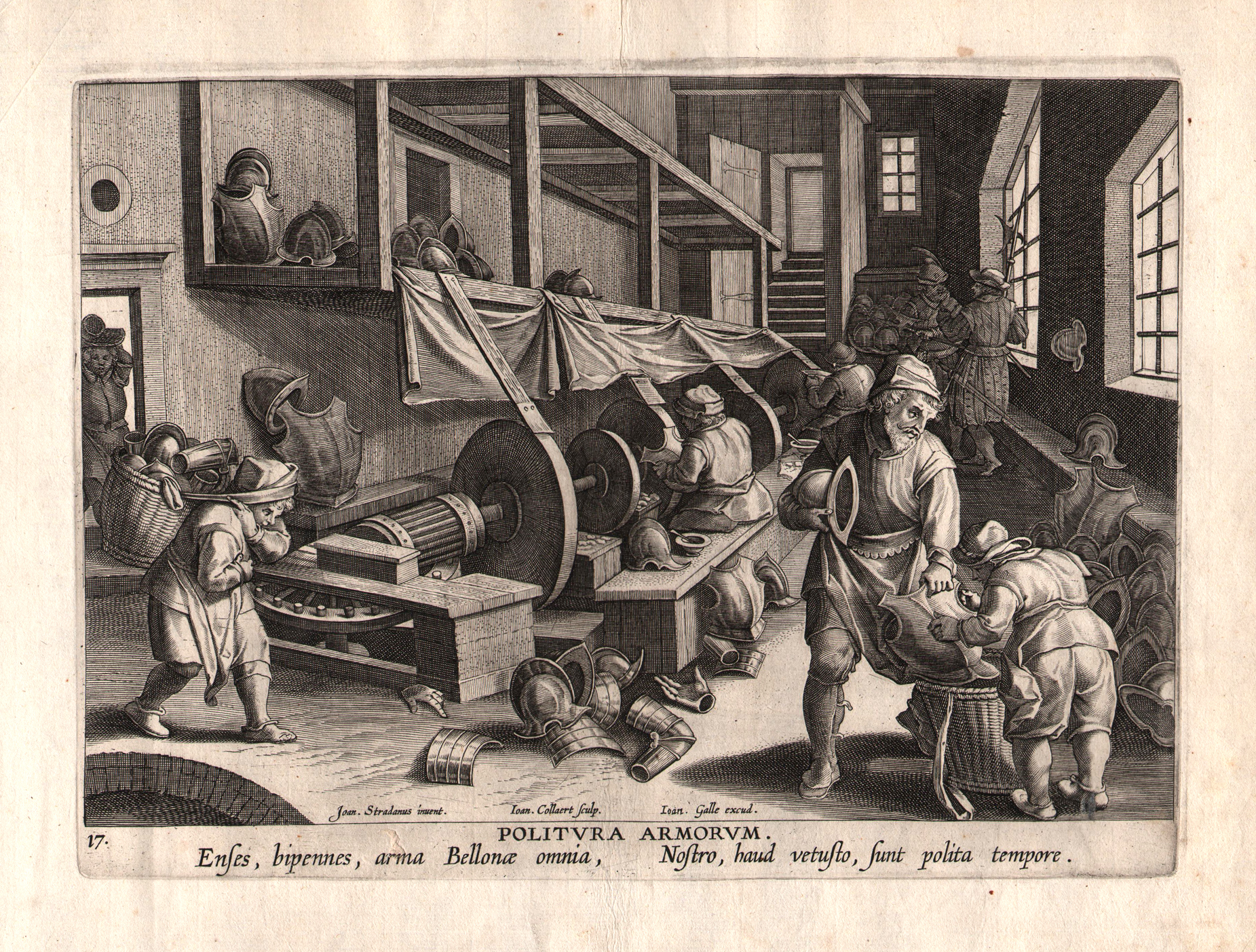

Our last examples are prints by Stradanus. In one of them, the wheels look like they have wood grain, but I think it's just an artifact of digitization. There are five wheels shown, and four of them have splash guards. This tells us that at least those four are used wet. Perhaps these are fed with grit and oil or grit and water. The wheel without the splash guard might be something different, or it may just be out of use. Thoughts?

I found a better version of the last woodcut here, except for the water marks.
I resized it up a bit, at least as far as the forum would allow. I'm not seeing a trough under the first wheel, but you can see now that both of the polishers have a bowl with a applicator next to them.

Ok, I found the full resolution version of the woodcut here:
http://www.renzocampanini.it/file/opere ... rmorum.jpg

Excellent! I searched the other day but did not do nearly so well.
Good call! I had failed to notice the bowls/applicators before. That really makes my day! I'm thinking that the bowls probably contain oil.Jason Grimes wrote:I'm not seeing a trough under the first wheel, but you can see now that both of the polishers have a bowl with a applicator next to them.
In the blow up, we can see some mysterious objects sitting there between the wheels. I'm sure they're not potato chips.... The ones in the second station seem to have a lot or depth.... Bits of cotton, tow, or rags to wipe the work? Whatever they are, a guy needs more than one of them, so that rules out flint nodules to "deaden" the cut. (that's a thing that you do on glue-n-grit wheels)

Those are generally called "set up wheels". Holtzapffel describes them in some detail as do a lot of early 20th C manuals on general shop practice. They were used pretty routinely until the advent of good bonded abrasives in the middle of the 20th C. The traditional glue was hide glue, and all descriptions of the management of them recommend removing the old "head" before setting them back up. They are always used dry.Jason Grimes wrote:.... there are some descriptions of grinding/polishing wheels in the "Practical Blacksmith" at the end of volume 2. At this time (late 19th century) they were still making wooden wheels with leather or felt tacked on the edge. Then emery was glued to the surface. They don't say what kind of glue but do mention that it needs to be heated up before use. I'm assuming it was some kind of hide or bone glue as they also said that it was susceptible to moisture? In fact they said that, now and then, you need to remove the old glue/emery. To do so, you soak the wheel in hot water and scrape it off. Not something you want to run through a water trough.
I use some set up wheels in my shop. They are amazingly cheep to run if you can get the knack setting them up. I'm currently struggling with glue adhesion problems....
