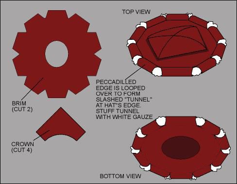

Here's a quick sketch of how I used to make them:
Hmmmmm
My brim pattern is just approximated here. Actually the cutouts should look perhaps look more like like diamonds or ovals---not "V" notches. At any rate I hope you get the idea. The edge curls up and over and is sewn down onto the top of the hat. This produces that slashed tunnel at the edge. Then you pull a wad of loose fabric through there as stuffing to create the "puffs". Does that make sense? Finally, add ostrich feathers liberally!!!
Buckramis kinda like a piece of loose-weave white fabric that has been soaked in glue. It's the stuff that has been traditionally used to stiffen constructed fabric hats---at least during the 19th and early 20th centuries. It varies in thichness and degree of stiffness. For the German hat you need it to be pretty damned stiff or the brim will be undesirably floppy. Of course, you could make anything do in a pinch, as others have noted: plastic, cardboard, a straw hat, papier mache, etc., etc.
Maybe a shop that does bridal wear would have sheet buckram or even premade buckram hat forms? Look for a shop that has "Millinery Supplies."
Good Luck!
Tim

There are two types of crowns for square top berets. One is sewn so the pieces make an X on the top of the hat and the final piece does not fold inward, the other is where the square is very large and the ends are folded into meet at the center.
In the case where it does not fold, it is 4 triangles for the top of the crown and one square with a hole in the center for the bottom of the crown.
Its easiest for me to make a crown "top" and Crown "bottom", where the bottom of the crown has the hole in it (which then attaches to the brim).
Either crown needs to be tacked all around the corners and sides to the brim or it will pop up from your head and look very silly.
Both need to have some grossgrain ribbon or something as a head band inside the head hole that tacks the seam between the brim and crown up into the crown.
I use premade milinery hat brims that I buy at a Milinery Supply store in LA. Its not hard to make them yourself from buckram and milinery wire, but its definitely easier to just buy one. You can order the brims by phone and they'll mail them out. I've usually driven there, but its a very scary neighborhood.
Using buckram helps keep the hats lighter in weight.
Juliana
