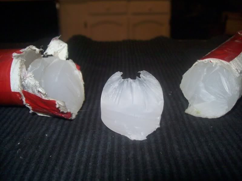

The piece I got says - Tecafine P/P Dia 1.250 - on it and I did have it wrapped from tip to hilt in the crossed pattern 2" strapping tape and an outer layer of 1.5" athletic tape with a single strip of electrical tape to mark the "blade"
When it broke it basically shattered into 3 pieces. The piece I had in my hand, a small wedge shaped chunk in the middle of the break and about a 6" chunk that flew off and fortunately hit the ground a few feet away since the swing was at a downward angle.
As you can see from the picture below the small wedge would easily go into a helm and could pose a potential issue. The larger chunk off the end could have also easily flown 20'" to 30 feet no problem if it had been a sideways stroke rather than a downward stroke.
I took these pictures after I had cut the jagged end off of the main section of the stick which I then used to make a pell stick for my kid and I used another portion to make quillions for my secondary sword used at Estrella. It did work well for that application. :wink:

OK then. This material is crap and breaks in a manner that can and has produced small slivers of jagged plastic that can enter into the eyeslot of a helmet as well as throwing large heavy chunks of rigid material great distances regardless of strapping tape.
I provided pictures for your viewing pleasure. Please do not disregard them.

Depends, there are different types of polypropylene.
http://www.bpf.co.uk/Plastipedia/Polymers/PP.aspx
Homopolymers - A General Purpose Grade that can be used in a variety of different applications.
Block copolymers - incorporating 5-15% ethylene, have much improved impact resistance extending to temperatures below -20oC. Their toughness can be further enhanced by the addition of impact modifiers, traditionally elastomers in a blending process.
Random copolymers - incorporate co-monomer units arranged randomly (as distinct from discrete blocks) along the polypropylene long chain molecule. Such polymers typically containing 1-7% ethylene are selected where a lower melting point, more flexibility and enhanced clarity are advantageous.
Different PP grades are available dependent on the application and chosen processing method.
TECAFINE™ PP (Polypropylene)
http://www.totalplastics.com/products/328
"Tecafine™ PP (polypropylene) is a polypropylene, random copolymer polyolefin engineering plastic"
Now if you go back to the previous page, my posts towards the top I posted an image of the label that came on my 3' rod from McMaster-Carr. It is listed on the label as co-polymer 7823. A google search on co-polymer 7823 turns up a product call Pro-Fax 7823 by LyondellBasell. That matches the information on the MSDS I requested from McMaster-Carr. Pro-Fax 7823 is a Polypropylene Impact Copolymer.
From that I can gather from the MSDS, property specs on the Lyondell Basell website, and specs found online for the different types of Polypropylene, I'm thinking that Impact copolymers are a class of Block copolymers or specialized Block copolymers that have become a new type in the industry. It is not a Random copolymer of any type that I can see.
So, In my opinion, what I have and Count Johnathan have/had are both polypropylene rods but are of different types of polypropylene makeups. If anything, this means we have to pay attention to the type or polymer makeup.

That is interesting and makes sense. What I saw in the BAmos video was definately a different kind of break so I guess not all polypropylene rods are created equal.
So I will correct my previous statement and say Tecafine PP is crap. If you get it send it back and get the right stuff.
