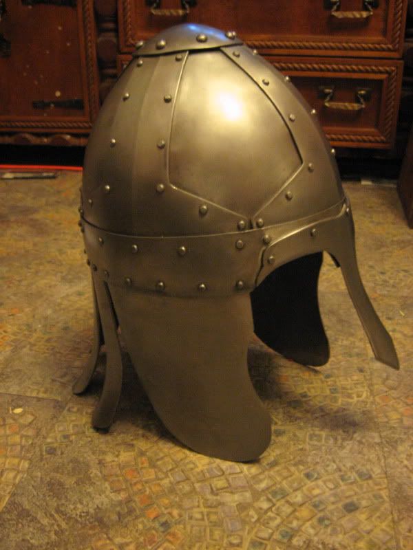

Hey all I thought I'd show you all a new spangen I'm working on.
Almost finished (except for the grill, that comes last).
The bowl and cheeks are 14ga and the nasal and slats are 12ga.
Let me know what you think.
Pedro

sweet.

wow I really like that :) bet its heavy as a bear though :)

That's frickin' cherry. I can see you put a lot of attention into detail.
I was about to yell "HEADSMASHER!" (it's a pet peeve of mine), but then I noticed that they're all smashed evenly... or else it looks like it. It's a good effect, looks like the materials didn't come over mail order that way.
Yeah, that's solid... I would have done the vertical strips out of 16g and felt perfectly happy with it.
I like how you didn't smash down the cap. (An advantage of 12g I guess). But why did you use a different size rivet on the cap?
It's an outstanding hat, and it'll make someone very happy.

Ha, inspired by the same style as my own current project! Just a TAD beefier than mine, though. Nicely put together, very neat!

I love it!!! Great job.

Thanks, the different rivets on the top-cap were a customer request (no idea why) but I think it works and doesn't detract from the overall look of the helmet.
And you guys are right, it's a heavy-ish (not too bad though) helmet but the guy is a new SCA fighter and I think it will stand up to more punishment this way.
Either way, he'll have a decent looking helmet for a good number of years.

That sure is a nice helm, my favorite type of spangen. :D
Jolly well done.

Too low unless the price is without bar-grill... in which case it is still too low but less so.
Fine work, a good subtle shape and a mix of 12 and 14 gauge. Buyers often underestimate the amount of extra work that goes into shaping the thicker metal and only think about the material cost. Even with heat to make the thicker metal move a production armorer has to pay for the fuel for the torch as well as amortizing the cost of the torch itself.
That price for a CUSTOM helm is more then fair. If you don't think so total up your hours on it (including the helm that was too small) and divide that into the price and see if you wouldn't be more profitible working at McDonalds.
Please do a careful job with the bar visor and make it low-profile so it dosn't detract from the rest of the helmet. You have done such a nice job that it would be a shame to ruin it with with a sloppy visor.

It's based on several types (modified to SCA standards of course) I tried to keep the most authentic look possible while still accomodating the customer.
Yes there is a band supporting the slats, it's installed now (12 ga hardened).
The grill is the last part I need to make. Going to pickup the steel tomorrow from my source.
Hopefully I can get the hang of this gas welder in time. I hate to waste good steel rod...

Pedro Ramirez wrote:Syr Brandr,
Very good! Thx.
Oh, and I like to have the grill blackened to help hide it as well as attaching as much to the Inside of the cheeks as possible!
