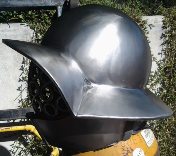

Need to show this gladiator helmet off.
Post by GuntherofOrkney »
A buddy of mine had me make him a gladiator helmet out of mild steel. After thinking about it for a while i started working on it and it went together fast. though i did make 3 sets of cheeks until i was happy with the shape. The thing weighs a good amount but its a 12ga mild steel top and 14ga for the rest with 1/4"round bar welded to the edges. My buddy got a great helmet at a great price and when we blacken it i will post pics also.

Cool helm... I like the rings for the grill, it looks real.
Yes more pics of the patina when ready.

That looks nice Gunther good work. Is that a downward turned large roll around the brim? Or a Triangle roll? I cant see it clear in the pics but what I do see of it looks awesome.

naw man its just a welded on 1/4" thick round bar.

GuntherofOrkney wrote:naw man its just a welded on 1/4" thick round bar.
so is it welded to the bottom-edge or the brim rather than the edge-edge of the brim? I hope that question makes sense... regardless of how its done it looks great.

its kinda set underneath the brim then welded so it gives the thickest amount of metal so it will resit denting as much as possible and the flat edge at the front looks cool too.
