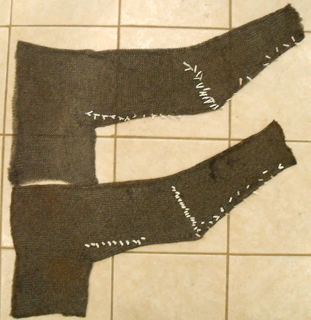

Here is what the shoulder and upper arm piece looked like the other day...
...and here is what they look like now.
The big change was to shift the upper arm with respect to the center line of the shoulder. This has the effect of rotation the point of the elbow more toward the back. I also crowded the upper arm reductions more toward the armpit. All in all, it is more like the originals. The spiral binding of the note book in the background lines up with the top of the shoulder in both cases.
I had the piece partially stitched together last night, and the armpit looked good, but I had a one ring discrepancy at the point of the elbow that I could not reconcile. It turns out to have been a mistake in the fabric. Mistakes hide more easily on riveted mail than in butted stuff.
I need to find a bigger piece of paper to record this all on before I close it up again. In order to fit it on the notebook, I have to stretch it pretty hard. I would like the "paper pattern" to be in a more even and relaxed state.

Do you have an art supply store handy? They sell very large (3x4 foot, say) grid-lined pads of paper that would make an excellent base for your pattern. I use them for recording hosen patterns and the like.
This sort of thing: http://www.amazon.com/Adams-Easel-Inche ... grid+paper
Posts: 9670
Location: Jeffersonville, PA
Re: Tailoring a mail sleeve
Post by Mac »
Arrakis,
Splendid idea! I had just resigned myself to using a roll of white butcher paper, but the grid lines on the product you suggested will help quite a bit. It looks like the Office Despot carries them. I'll go get one now.....

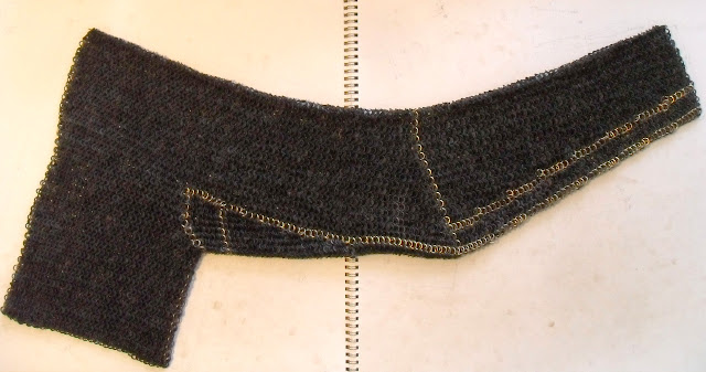

Here is the completed sleeve. I may tweak it a bit, but maybe not.
Here it is compared to the smaller of Wade's sleeves.
If I changed anything, it would be to lengthen the upper arm by two columns, and take about three columns off the forearm. I'm not sure it is worth the effort for so small a change.
Robert MacPherson

Yes on 1, no on 2. As I mentioned, it was hard finding any two that followed the same construction. Some have really big sleeves, with the armscye down near the waist--undoubtedly to accommodate the fashion beneath (similar to your C3 but without the horizontal joint, merely both sleeve ends stair-stepping down to a single point), some were cross-grained, some as the extended gusset I mentioned, some cobbled together in an almost incomprehensible manner.
Out of curiousity, Mac, are the brass rings in your reconstruction on the "back" of the sleeve? I always operated under the presumption that contractions are a chink, a weakness in the armor, and should be placed in the area least susceptible to attack. I think Wallace A7 has thicker rings in the collar and armpit--areas not covered by additional plate armor.

Ernst wrote:Out of curiousity, Mac, are the brass rings in your reconstruction on the "back" of the sleeve? I always operated under the presumption that contractions are a chink, a weakness in the armor, and should be placed in the area least susceptible to attack. I think Wallace A7 has thicker rings in the collar and armpit--areas not covered by additional plate armor.
Yes. The row reductions (marked in brass) will be in the back. Some of the brass rings in the armpit are visible from the front, but the majority can only be seen on the back.

Which sleeve was the one that you brought to Texas?

Assuming I actually brought the one I planned to bring (a pretty good guess, it was the more stable one) that would be M-15, which is the larger sized one with the looser weave one of the 2.

I am working on tailoring an existing "tube" sleeved hauberk from IceFalcon. In your diagram, 3C is very close to what I've done. I have not done anything with the angle of the elbow, just taken the existing tube sleeve and cut it on a taper to close up; the only difference is that I have not staggered the taper on both sides (it is symmetrical reduction). It seems promising in it's simplicity, though the end result won't be nearly as nice as yours.
Can't wait to see what they can produce from your example.

I think that the actual end result will depend a lot on the geometry between your size and the size and density of the rings. In my case I was making 9mm mail for a child so the geometry was really, really bad. I did a 2/3 sleeve without an elbow and a full sleeve with an elbow. Both tapered to varying extents - probably not quite enough, but they definitely tapered.
With large flat rings and a very small arm, the sleeves with the bend in the elbow definitely worked better. They allowed easy, unimpeded movement. The sleeves without the elbows didn't move as nicely. The arms bunched too much in the inside of the elbow.
You may easily find that yours work better if the overall geometry ends up with a more open feel, but you may also find that an elbow is worth adding. As long as you have some rings, it isn't that hard.

I got to put my grubby gauntlets on all 3 sleeves pictured in this thread yesterday. First time getting to handle historical mail - it's *really* impressive!
I also got to try on the tailored sleeve that Mac did. It was too big for me, but even throughout. The elbow doesn't bunch up when flexing, and doesn't seem like it would try to pull away from the body with moving the arm around. I may have to sell my current 9mm stainless voiders and get a set of the 6mm tailored ones.
Special thank you to Wade Allen for letting me play with the mail, and all the advice!
