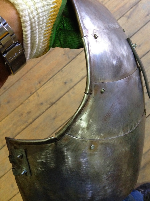

Okay, I got some more work done on the back plate. I had to remake the third plate, and I thought I may have to remake it again, but I think it may work out as it is.
Looks like I have the backplate tilted too far back in this picture. The edge of the lower plate doesn't quite line up with the edge of the plate above it, but I am hoping this won't end up mattering too much. Also, I feel like I need to puff out the centre of the breastplate a little bit.
Strangely enough, you can't see the backplate in this last photo. You can see it a couple inches to either side of the breastplate in real life. Maybe I will take another look with just one eye. I think I will puff out the bottoms of the plackart a little bit after I detatch it from the breastplate.
Fitting all this stuff together is really tough!
Re: Building a Milanese Curiass - progress
Trim the upper one, draw the edge of the lower one, I think it'll be ok.The edge of the lower plate doesn't quite line up with the edge of the plate above it
The first picture strongly resembles the picture of Avant backplate from Dupras's thesis. I like it.

- backplate.jpg (99.3 KiB) Viewed 106 times

Nick,Nicknizh wrote:And while we are on topic of backplates, Mac, can you tell us how you treat the overlapping rolls of such pieces? I've yet to discover a surefire way to make them pretty and flush.
If you show us some pics of places you have had trouble, I might have specific advise, but in general....
--trim the edges to a nice curve while the plates are temporarily assembled.
--mark the place where the hem will begin with a sharpy marker on the inside.
--cut away the underlaping material from the line to the edge. The hem allowance will now be only one layer at the transitions, and the allowances from adjacent plates will abut one another.
--thin the edges of the hem allowances a bit under the hammer so they will roll nicely, but take care to do it evenly and don't let them get too thin.
--grind or file the edges to a smooth curve again. (the thinning process will have left them a bit uneven)
--separate the parts and begin the hems.
--when the hems are 3/4 turned, reassemble the parts an make sure that the curve is still smooth. The "poison effect" will make the ends of the hems behave badly, so give them the full benefit of your art.
--separate the parts and continue turning the hems.
--reassemble the parts and make any necessary adjustments to the hems at the transitions.
--curse in your native language if the curve is can not be made to be as smooth as you would have liked.
--vow to do it all more carefully next time.
Robert MacPherson
Initially, I screwed up pretty badly, I think the main reason is that I rolled the top piece to 3/4 and then trimmed the next one and so on. In the end, I trimmed them incorrectly and thus there were such gaps, and it was done 1,5 years ago. I somehow reworked the rolles last summer.
Yea, next time I'll to do it your way, thank you.--vow to do it all more carefully next time.
