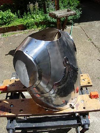

You might find some of the cuirass designs I have been doing useful. This is a pic of the most recent.
I'm hoping to include the patterns on the site eventually.
Mike
