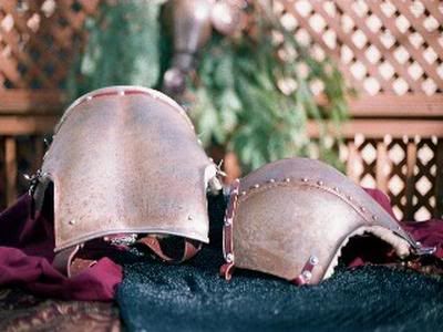

It's not a very good picture, and certainly isn't an historical example,
but here's one that I did a few years ago.
If I were to do another, I'd mark the areas on the
lower abdomen where the bulge is greatest, and then
I'd bouge the entire surface to blend the curvature.
All surfaces are hammer-worked, even those areas
that don't *seem* to be dished.
Idëval
Idëval
